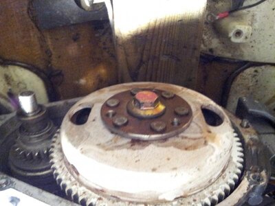

Heres a pic, anyone have any idea why its white ?
WFO Speedracer
Alabama
Take a propane torch and heat up the steel center hub of the flywheel with the puller attached, then smack the end of the puller bolt with a hammer, sometimes you have to do this several times, tighten the bolt, heat the hub , smack the puller bolt, it should break free.

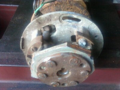

When all else fails there is always this option , so yes technically you can split a Yamaha 701 case without removing the flywheel, or at least without removing all of it lol.
I was able to get it off thanks to your tips, heated it up hit it a few times then it came right off with the impact.
Thankfully I didn't have to chop it off, don't think mine was quite as rusty as yours.

That particular one came out of a saltwater ski, that stayed docked out by the ocean all of it life, I used a snap on puller, heat, a 5 lb sledge hammer, more heat, left the puller on for two weeks straight, stripped out the three bolt holes, what you see there was a last resort to save a decent set of 62t cases, flywheel, crank and stator were toast anyway.
