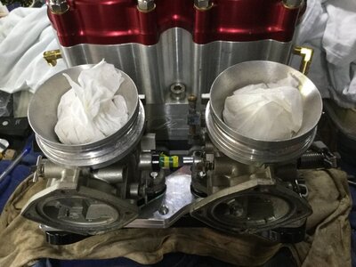

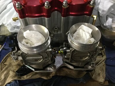

In my 1055 Dasa project, I have the choice for carb pump install, what is the best way to install them ?
Carb pump on engine side or external side , my trottle cable can do both.
Thanks
I saw a guy in Daytona with an fx1 where the carbs where mounted with the pump towards cylinder. He had an access plate to where he could change jets without pulling carbs. Pretty neat, thought about doing it on a test ski.
