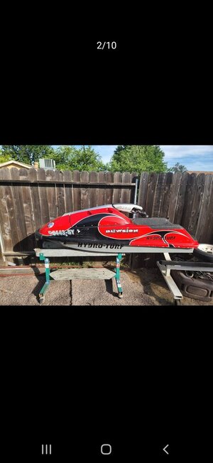

When I built my superjet, it was a all new combo and I went with the most recommended carb setup via the carb database list because carbs are not my strong point lol. Dual 44's on a modded 760, everyone likes 125L and 115H and tune from there. Sure enough, the ski started right up, idled good, good throttle response out of the box. Well, my buddy hates reverse jetting. He was mean to me and said my ski was slow lolol. Between that and another issue, he convinced me to go normal jetting this season. So stock low speed jets, and one step up on the highs. First ride is telling me I need to step the highs down, back to stock.
So stock jetting, on a highly modified setup.

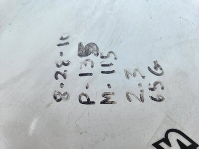

So in other words he knows the hull but he don't know poop about the motor or its tuning requirements lol tell him to sit down and stfu! If it's not reverse jetted, there is a large chance of running lean in the midrange on deceleration and siezing. 44s are 44s so don't buy into the BS on that. Nothing wrong with oem 760 44s. Properly jetted they rip as good as AM 44s lol. Suckers. These are the jets I recommended in a badass ported 84mm bore 61x cyl with oem 44s b pipe and I'd put it's power and throttle response against anybodys junk that thinks it runs better

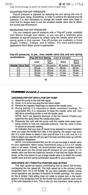

Mikuni says the highest popoff with the smallest needle possible with proper running is the way to attain the best tuning. The 1.5 needle can flow more fuel than the engine can ever burn. Yet you see people running 2.0 2.3. 10 psi popoff. All that.

According to mikuni. The manufacturer of the carburetors. It DOES matter. But people do what people do. They tinker and find things that work for particular setups. They convince themselves of results and atrribute that to their own genius. Negating the fact that engine theory is over a century old. And not up for conjecture. It's black and white.

Like I said. A bunch of conjecture. From a bunch of amateurs. None of you make your living building engines. Mikuni makes their living building carbs. I include myself in this statement.
You need to go to the Mikuni forum then. Everyone here is too dumb to help you.
I didn't ask for help. I posted the mikuni manual that SPECIFICALLY states that tuners will recommend larger seats. And that is wrong. But I guess you didn't read that. O well. What's that they say about a horse and water? They ride jet skis on it?
