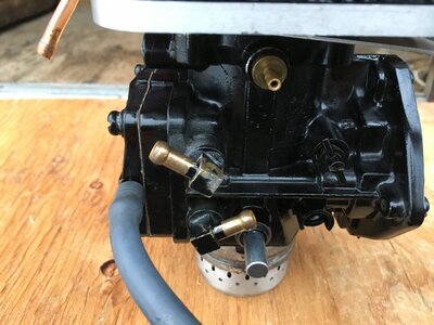

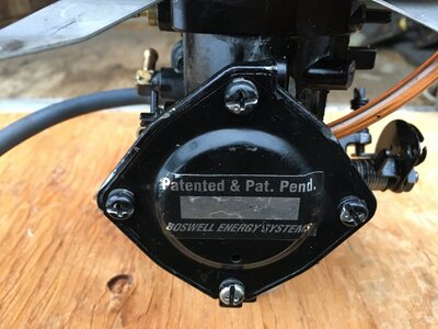

Looks like a snowmobile thing that maybe tried to crossover?
https://www.snowest.com/forum/archive/index.php/t-115963.html
"Boswell modified carbs are a whole new beast. Forget everything you know about a standard carb. You would be best to try and find a sheet that show's how the circuits work in them.
Great carb once you understand them.
The company has gone out of business and the owner is in Jail due to money problems. "

The heart of the technology features tiny holes bored through the wall of the venturi into existing active and originally inactive circuits that lead to the needle jet area of the carb body, where differential air pressure exists. "
Call me crazy, but it doesn't look to me like those holes in that picture go into the venturi, nor into any "active or originally inactive circuits". If they were doing something with the venturi or something that had anything to do with an actual carb circuit, I would have an easier time believing that it does SOMETHING, even if it probably has nothing to do with "improved fuel vaporization". But that picture sure looks like holes in the mounting flange that go nowhere, and the description sure sounds like a bunch of marketing wank. The air/fuel mixture in a two stroke takes a long and torturous path from the carburetor through the reeds crankcase, transfer ports, into the combustion chamber where it's mixed with a bunch of left over exhaust and partially stuffed out the exhaust port then partially stuffed back in by the pipe. Any claims of increasing atomization or vaporization from a carburetor on a two stroke seem dubious at best.
