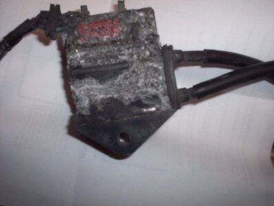

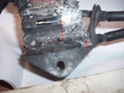

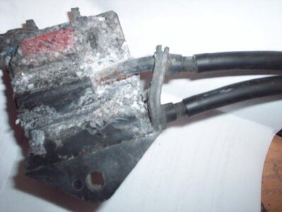

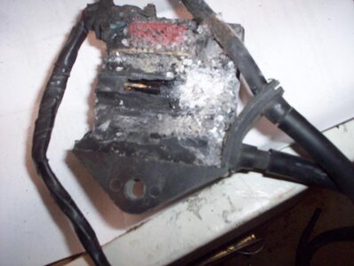

Will, I have one I have already cut up, let me look at it for you.

:trink26: Note the last picture, the red arrows show where the start of the hard plastic starts that the wire is pushed into.
