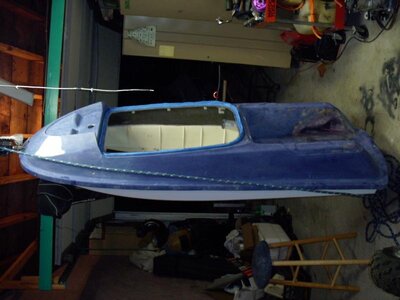

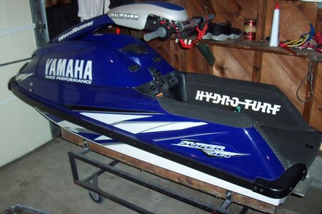

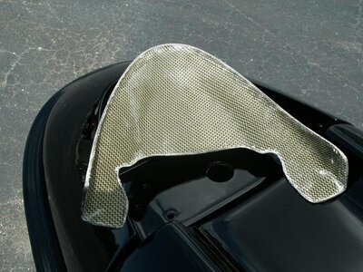

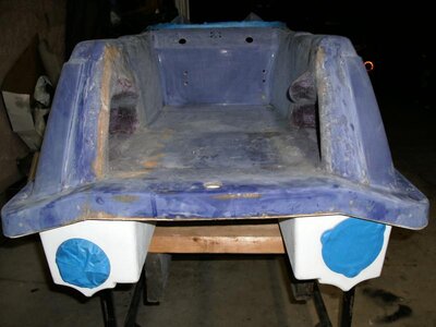

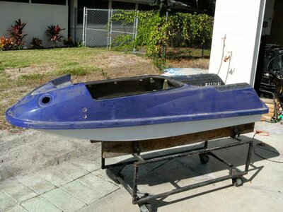

what we got here is a couple of before pics and some stripage and sanding action. foot holds are a cgracing product i had won at daytona freeride 06' , lool like a cross bread cyclone and rickter pretty comfy too. they went in nice with alittle epoxy glue and reinforced with 1708 mat curtiousy of fiberglass coatings.

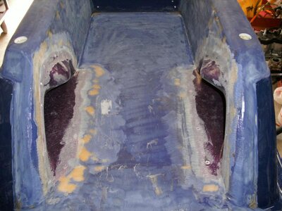

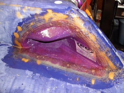

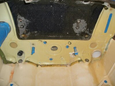

footholds.

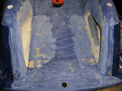

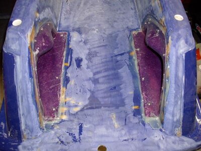

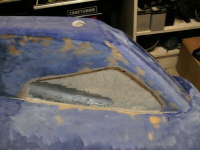

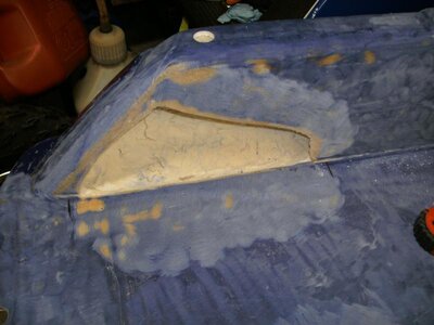

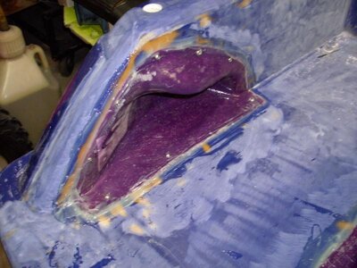

next is the scupper. pain in the a$$ but it was fun. xmetal scupper some foam and a 12 pack later.

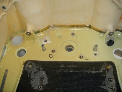

jetskidude
"dirty sanchez"

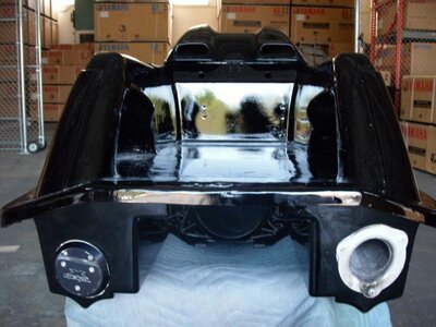

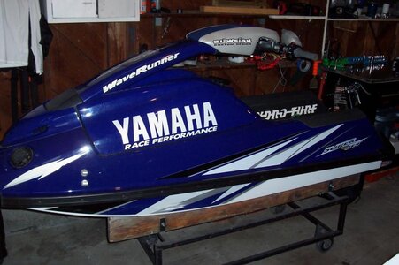

well now the fuel fill is closed off, bondline cut down and managed to lose 1 1/4 lbs off the hull. all the parts are at xscream getting built, motor, pole,trim,gas tank mod ,steering,nic nacs and ex.... the hull and xmetal hood/nose piece are at the paint shop. will be back with further progress soon.

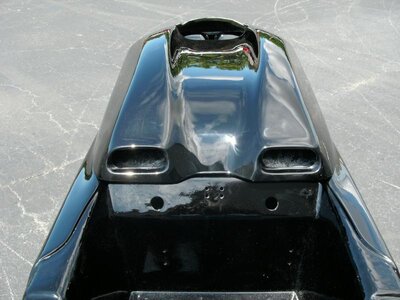

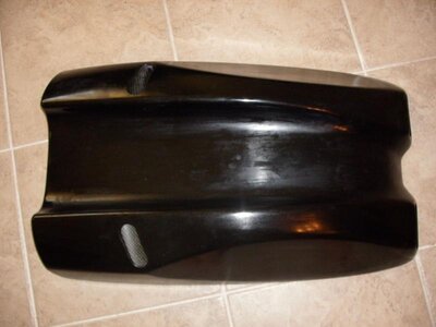

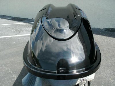

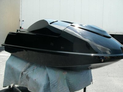

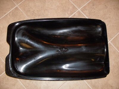

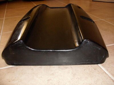

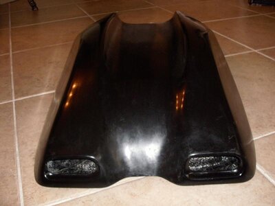

the hood is made be xscream , probly the best hood on the market. lightest,strongest,lowest,cheapest,best looking s.o.b. around.

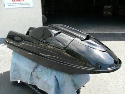

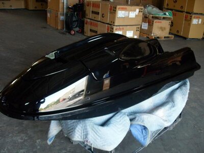

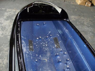

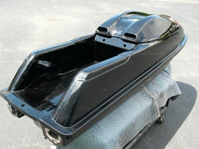

finally back from the paint shop.
i did the common gloss black with a few ghost graphics that the camera wont pick it up so i guess you'll have to see for your self in person. when the motor is done i will start putting her together if those dam handlepoles ever get done. the powdercoater mest them up so they have to sand and redo the entire batch of poles. suck's. o'well there is still plenty of work to do,me and a buddy will start hydro-turfing this weekend.

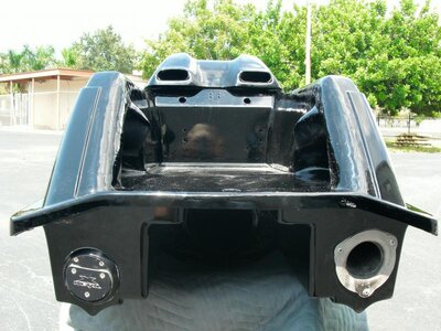

oh yeah the paint job cost 300$.
