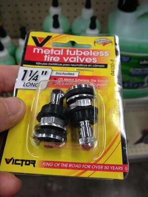

So I was working on my ski and my pisser was loose. I tried to tighten it and it broke off in may hand! Damn. So I started searching and the cheapest pisser is $15+$8 shipping and a week away.

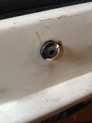

I went to discount auto parts store looking for a rubber valve stem to use as a temporary replacement, and found THIS for $5! They are made of chrome plated brass, and come with nice rubber seals! Got two of them for $5!
Simply remove the internal valve assembly (I did it right there, just asked to borrow a valve stem remover) and you are in business!
