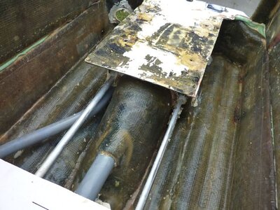

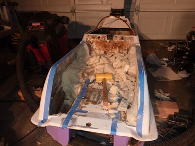

Well I defoamed and she now ways in at 89lbs with the hood. After at least a year out of the water The foam was wet in isolated areas around the cooling line entry to the engine bay and the PVC that the driveline runs though. I'm going to seal these up good, put drain holes in the back. Layer the first few inches with closed cell foam then fill it with 4lb expansion. Hopefully all the water will be able to work it's way to the bottom and out the rear.
