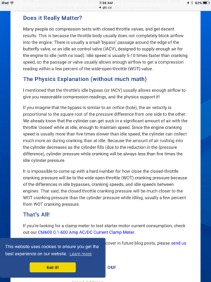

Apparently this WOT thing needs some clarification for the guys who feel the need to post just for the sake of arguing.
Yes, you will eventually arrive at the same max compression number with open or closed throttle plates. But on an a real high performance race or freestyle engine like the stuff I work on with 250+ psi I prefer to open the plates to arrive at the max number in as few kicks or recoil pulls as possible because it’s not fun crushing the instep of my foot on 15 kicks when it can be done in 7 or 8...
I’m sure you probably wouldn’t notice the difference in a scooter engine with a piston the size of a thimble on an engine with a compression ratio designed to basically run on junk fuel while commuting the public around China and India though...
Wasn't trying to argue, just stating my findings. I still hold it open, sometimes I just forget to do it...
