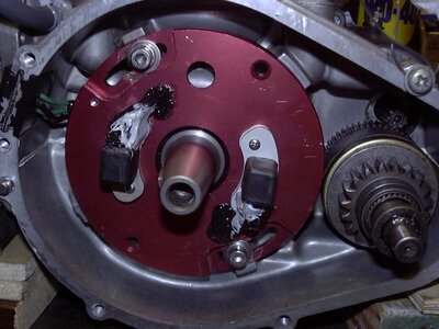

Does anyone have any pics of the mounted msd pick up plate on a motor .. I am not sure how to route the wires through the plate so they don't rub ( do u silicone them to the plate ) and where they come through the rubber grommet, the 2 forward most wires are right in line with fly wheel gear. The flywheel gear is only like maybe 3 mm away from the 2 forward holes.. This is my first at hooking up dual pick up total loss...
Any help would be great..
I am told there is a thread on concerns with the wires on the trigger plate but have yet to be able to find it..

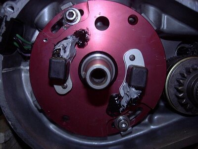

Hope this helps some, I use to have better pics but must have deleted them...
There is a known issue with the wires fracturing internally just where they enter the pick- ups. It appears that there is a bit of vibration created by the rotating flywheel. I prefer to relocate the 2nd pick-up wires to the rear of the plate and most importantly glue them down with RTV just where they enter the pick-ups. Have not had any failures of wires since I first figured it out in 1994. Looks a bit cobby but works nicely.
