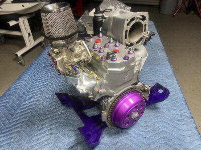

Any Hot products dealer can get you the WarecraftWerks manifold. John at Watcon is also an excellent source. Have him also get you a new SBN 44, as well. And, intake gaskets.
You'll also need a flame arrestor adapter and a flame arrestor.
As far as jetting goes...what elevation are you riding at? You can get ahold of me and I can give you a good starting point.
There's also a little adapter you can buy to bolt the sbn on the stock manifold. If you can find a reed cylinder single 44 manifold. It'll probably not be cheap. Jetting will probably around the 100-110 pilot, 110-120 main, 20-25 psi popoff depending on which flame arrestor you choose.
Keihins are not difficult to tune or rebuild, the issue is availability of parts and jets to tune it more than anything.

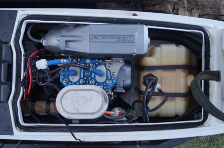

Note: Flame arrestor has long since been changed to stock. Fuel lines have all been replaced. Wax Racing Products internal fuel fill has been added.

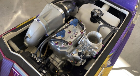

I notice that @Aquaholic 's SBN is reversed (with fuel pump outboard) from how it would be oriented in a SN SJ or FX-1 (with fuel pump inboard).

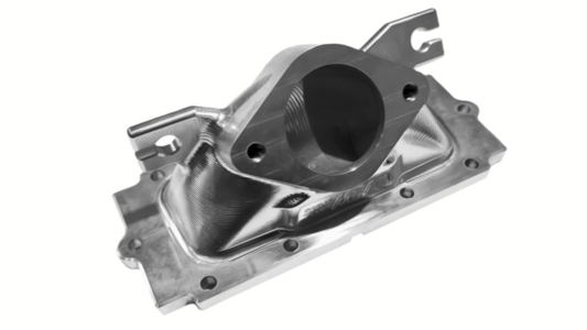

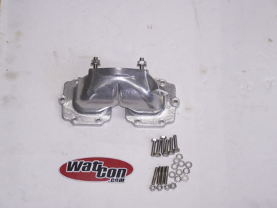

@Aquaholic is this the manifold you used?
John Zigler's photo does not appear to have ambidexterous brackets:
Yes.watercraftWerks. My bad. Senior moment.

@WFO Speedracer I noticed that too. Basically it is $100 more for a CNC'd version with an ambidextrous throttle cable bracket.
