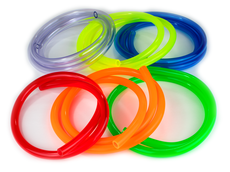

you can use 3/8" air hose or if you want to be fancy you can use this.

I thought I remembered seeing that but since I didn't know what pressure it was rated for, I wasn't sure about it.
