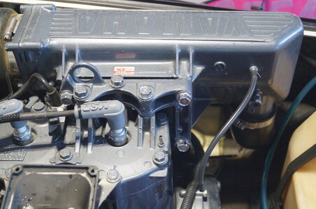

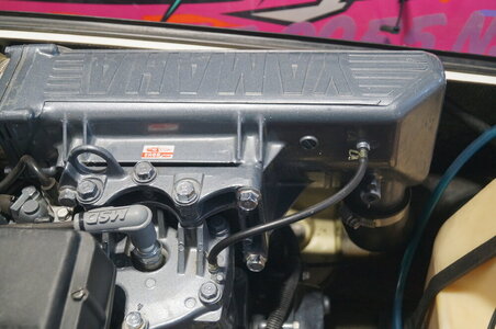

I was taking the carb off so I could take it apart to check the internal filter and, for the first time, I noticed this little hose was off.
Sure enough, although it is little, it really spews exhaust out. So, could that be it?
The original oem constant tension clamp is way too loose to do anything, but I think I have some constant tension clamps that size so I think I will forget about the carb for tonight and ride tomorrow and see how it goes.
Is water supposed to come out of the head into that little hose and then go to the muffler? If so no water was coming out when I just started it. But then again the ski is not in the water...
