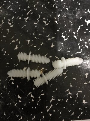

Ppl in The boat industry call em Christmas trees. Its used for Upholstry. Same thing i told u i saw on The wammer seat. I can get you The real term or name tomorrow. I can also Just send you a handful. Pm me

Ppl in The boat industry call em Christmas trees. Its used for Upholstry. Same thing i told u u saw on wammer a seat. I can get you The real term or nane tomorrow. I can also Just send you a handful. Pm me
How exactly do those install and what kind of flange or whatnot do they need on the part?
They work great on that blaster seat. And other upholstery on boats that I have personally seen go 90 mph. Exactly what your looking for bud. Trust me. You place them at different angles. Doesn't come off unless you pry at it and really want them off.
Arnt those for holding panels on though same as in a door panel...you would need a panel with the vinyl attached to it already which would than have those installed and than that press into the fibreglass to hold it on...would work in a boat fine but I am pretty sure vumad wants to wrap vinyl like a normal seat cover just with 25 mm underpad under it...I think your only real way to get it to work like you want will be to have the vinyl have two seams in it that runs the length of the seat, this will let the vinyl lay flat down the sides and than glue the vinyl to the bottom side to the seat...will just have to make sure seams are lined up but it's doable...have seen it done on car console lids...some heavy duty spray adhesive would probably do the trick
