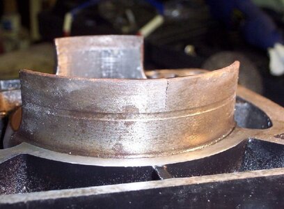

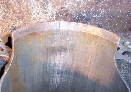

cracked sleeve, is this workable?
you could use a diegrider and cut that portion out like some engine builders do when porting, etc.
if you have the option to get your money back, id say go for it.
Mile9c1
X-H2O.com
Grand Rapids, MI
I've seen big bore cylinders that have had both the intake and exhaust sleeves cut off, because they get thin @ 84mm.... better to get rid of them than risk cracking them off.
It will probably cut down on your piston life, but who knows how much. Probably not much if you're not racing.
waxhead
wannabe backflipper
gold coast
wow there is no way i would do that
imagine the load on the sleeve
i run my 84 mil ones at full length
