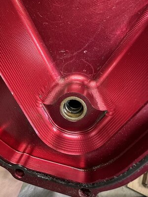

I didn’t see the washer on the exterior but did find my spring inside the cover. Need to pull the flywheel to see what the backside looks like. I did find some metal shavings in the flywheel cover. Not much; is that normal?

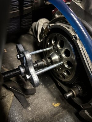

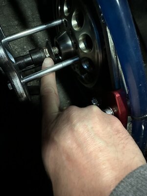

Before I fudge anything up, I was trying to remove the flywheel and it started to get pretty tight to turn the wrench and then the flywheel would turn with each crank of the wrench; what am I doing wrong if anything here? Just using a cheap flywheel remover? The bolt seemed to be screwing in with each crank of the wrench too. Should I use a different head attachment on the puller?

It’ll get tight before it pops, that’s normal.
I typically remove the bolt and use a smaller socket cap bolt In the snout of the crank for my puller bolt to sit on, prevents thread and snout damage.
If your using the flyhweel lock tool properly and it’s still spinning the flywheel then your ring gear sounds like it’s stripped. You’ll have to put a rope down your sparkplug
Hole and lock the motor up that way to keep the crank from spinning.
i also do what dylan said about the socket on the crank snout. Get the puller tight and then whack the end of the puller bolt with a hammer a few times. the shock helps it pop.
Perfect! Thanks for the tip on the socket. I will try that tonight.
I put the flywheel locker on afterwards but then didnt crank down anymore...figured I would make the post before I screwed something up.
You don't ever straight pull a taper fit. You hand tighten. Tap the end with a brass hammer. Tighten more. Brass hammer. Tighten more. I've never had one not pop. Cavemen reefing the puller down is why so many things get fubar

You can put a 17mm open end wrench on the end of the flywheel bolt and it will keep the flywheel from moving.

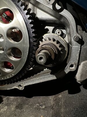

Finally got a new bendix installed and everything buttoned back up...noise is still there. Put my ear closer and sounds like the starter is fried. Sounds like a winch when its engaged. Does a DASA motor use a OEM yamaha starter or is there a better option? Thanks!
