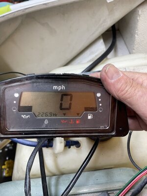

97 Waveventure, my 1st ski & went in blind on restoring it. I currently have it wired up (temporarily) all wires seemed evident by color where they went except 2 green coming from the stator . I was told it didn’t matter which green was plugged into each green. The engine cranks, but not one light on the dash comes on. Any advise what to look into?

Just to pass on some info. I had hooked up the battery to the red & black on the 4 pin connector on back of dash. I was told I had to add the green wire to the positive & it worked. Dash lights upIMG_0021.jpeg
