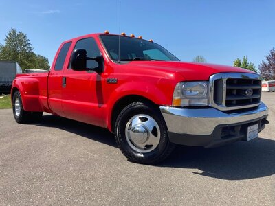

Bang for the buck if you just need something to haul, a good 7.3 cannot be beat. It just cant. And interior all the way up to 2010 is a direct bolt in swap... parts support is unlimited, cheap to own and maintain compared to most other diesels, no DEF, and with a VERY affordable tuner chip (300 bucks or so) you get great power or towing tunes. Any dodge is is going to fall apart with you inside it, piece by piece bit by bit. Any plastic component is on it's way out if it's not broken already. They also seem to rust faster than any others.
And no, not all duallys have been used to haul heavy. Plenty of street crawlers out there or people who are just not looking to abuse a SRW. My 350 dually was not used to haul outside of moving my RV a few times, the guy I got it from was an iraq vet who stored it most of its life, and it was FAR too clean. I paid 16k out the door for my red 2000 with manual transmission 4:10 gears and 140k miles in 2022.

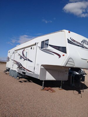

I want to haul something like this 36 ft. toy hauler, it's 12,000 lbs. dry, then have a Superjet and a couple motorcycles(a dirt and a street) in the 12' garage.
Does that warrant a 1 ton or will a 3/4 be more than plenty? Thank you guys again for the comments, I'm learning so much about these.
I’d say 1 ton. Not necessarily a dually though. The older the truck the less tow capacity it’s going to have, legally. My 2006 dodge 3500 2wd dually has less tow capacity than my 2012 srw 4x4 quad cab. And they both have less than my 2024 srw 3500 gmc. I tow a lot. And everything is heavy. They all will do it, some better than others.

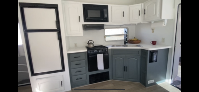

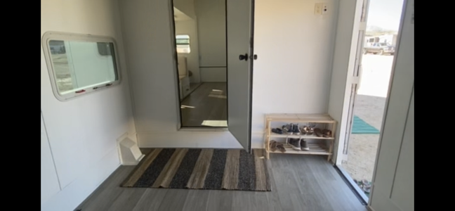

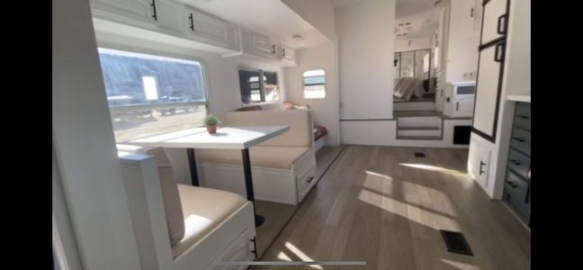

If you havent gotten a trailer yet I have a 37' Forest River with 12' garage that I spent months and allot of $ remodeling. All new floors, paint, corian counters. Took all decals off and wet sanded and buffed entire outside. New tires/wheels. Only problem is the frame cracked. Would let it go cheap. It's fixable, I did it once quickly without removing entire bedroom floor and just welded crack and gusseted over it and it lasted awhile. If you or someone you know can weld/fabricate good it wouldn't be bad...need to remove bedroom floor and replace both frame rails in the front where they attach to pinbox.
Towed it with an 04 LB7 duramax 2500 SRW with compound turbos and a few other mods. Definitely don't want to be towing a trailer that big with a 7.3 ford. I would probably get an LMM duramax and delete it if you don't mind the newer style seats/interior.
