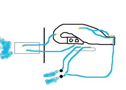

I was wonderin if I could get some tips from you guys. I just installed a dry pipe on a SXR and its just not performing as I thought it would have... It doesnt seem like ive gained top speed. Its more snappy, but sluggish on the very down low. Here's my setup, if could give me some ideas on what I can do that would be awesome.
150psi on both cylinders
Stock 40mm carbs
-2.0 Needle and Seat
-150 Main's
-80 Low Speed's
-80gram Spring's
Vilder Light weight flywheel w/ 5 degree advance
ProK Filters
Pump has dual cooling (too much water, wrong places?)
ANY help would great, as I'm going to be riding tmrw and any improvements that I can do in the morning would be a huge plus.

Been searching foever and its surprising how little information there is on water routing... I couldnt find anything that could help. Should I reduce the water going in/out, route it different? Any help would be great
