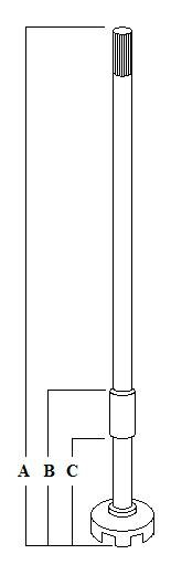

Building an X2 and need a shaft but don't know proper length. two questions. one, can anybody tell me the overall length. and two, does anybody know if a 750ss driveshaft will work. What skis share the same shafts? maybe X2 and 650Sx. any others? thanks-mikeb

X-2 is its own monster:
X2_________650___________A= 30.75"_____B= 10"_______C=8"
Other Kawi's:
SXR________800__________A= 28"________B= 10.5"_____C= 8.5"
SXI/SX______750__________A= 25"________B= 8.5"______C= 6.5"SXI PRO is the same but +.25 on the seal surface supposedly
SS/XI_______750 & SX 650 _A= 24.5"_______B= 7.5"______C= 5.5"
ZXI_________900/ 1100_____A= 21.5________B= 6"_______C= 4"
TS/SC______650__________A= 18.5________B= 5"_______C= 3"
