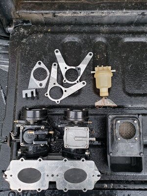

I have a set of dual 38's with intake and one plate. Assume they need rebuilt. $225 shipped. Also have reed cages and composite reeds if needed.
