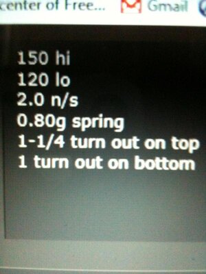

I found this info on here awhile back for tuning a 38. This is a good start point.
