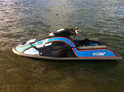

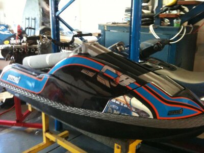

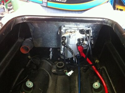

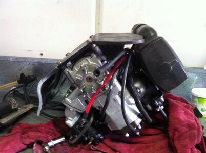

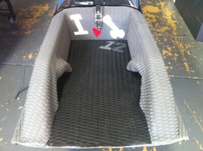

The build of my Q8 with completely stock SXR driveline is nearly done.
It is being built as a small surf fun boat that I can also thrash around and hit boat wakes and do some flatwater freestyle on.
The engine im running is from my old Stock Class SXR.
850CC
ADVENT INGNITION
Apart from that all stock.
Running stock pump with skat prop (i've forgotten what pitch prop i had in my race boat however it worked well for a mix of surf riding and racing so should do pretty good for freeride with the lighter hull).
RRP Pole
550 Tank

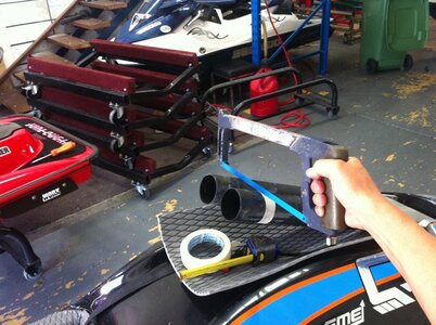

Superjet Waterbox.

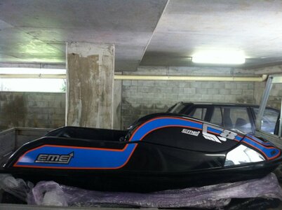

We had some issue's with the hull itself turning up with nothing other than hull and hood but Eric has sorted most of that out.
Building the ski is definately not a rookie build. not much lines up and most of it needs to be re drilled/aligned.
More info to come.
