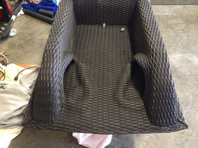

quick update.
Put a Jaz tank with the thrust billet filler in today as well as re did the fuel lines.
Next on the list:
Trim
Wider bars
shortening the pole
