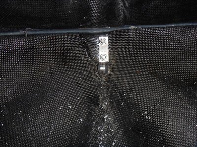

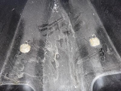

was looking in hull last night trying to plan everything out and noticed that there are 2 hooks in front of where the fuel tank goes and only one behind it and it doesn't look like it is going to be pulling down on tank
same problem with mount water box except there will be no hooks in the front
am i missing something or is that how it's supposed to be?

here are some pics maybe this can be explained to me, first with the 3 hooks in the 2 pictures not sure how i'm going to properly stap down fuel tank and waterbox?

when I did my straps...
First time:
for waterbox: two coming from the single hook way up front to those two inserts installed by eme that you have in your pics.
for tank: another two straps from the eme inserts crossed over the tank and to a hook that i mounted on the stator cover of my motor. I also glued a piece of 25mm padding to the bottom of the tank then glued the tank to the hull.
was kinda "hacked" all togther, but surprisingly everything stayed in there tight.
I got sick of the look of this and eventually water peeled up the padding, so i re did the whole thing.
2nd attempt:
for tank: I epoxied 4 inserts that i bought from mcmaster car using west systems w/ 404 filler, then a layer of carbon (2 in x 2 in square pieces)
much much cleaner look and better results.
so you ran the staps for the water box under the fuel tank?
these 2 hooks are on the engine side of the fuel tank, kinda fustrated with this was supposed to be simple parts swap from what i was told now seems like i should have bought one already done.
no mine were much further forward in the hull. pretty much a straight drop down from where the breather tubes are for handle pole.
i would just epoxy in your own inserts....
