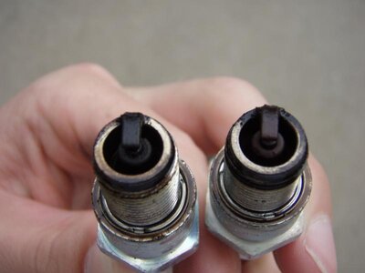

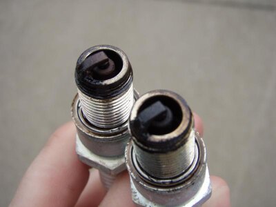

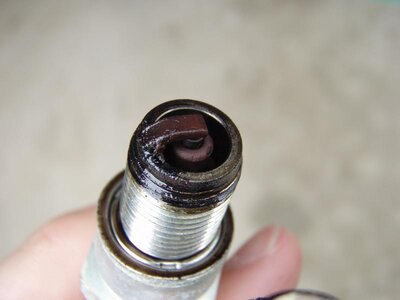

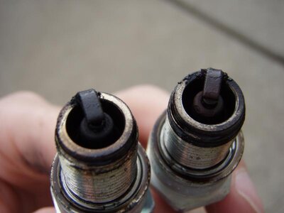

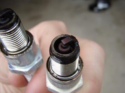

Heres my plugs after I got home yesterday... seems a little rich to me... I havent changed my plugs in about 40 hours of operation... how often do you guys change plugs? I used to only change them once a year.... but I am riding a lot more than I used to now since I got the sj....
Oh and the ski starts and runs awesome.... if the plugs didnt look rich to me I would not have expected it...
I did notice a little chip off the insulation on the one plug... is normal? maybe it came like that...

I would say a little rich. Should be chocolate milk colored.
I change mine about twice or 3 times per summer if I'm riding a lot.
Our type of throttle popping riding seems to love new plugs. You will actually notice a diff after putting them in IMO.

i can tell a big difference in old and new plugs. i see that posted a lot that only changed once a year or less. i cant do that, i probably change mine every 4 or 5 days of riding and i can always feel a little more response in the new ones.

cool... I have put about 30-40 hours on my ski of hard brapping already this year... I'll switch them out... ... I wanted to run a little rich... I was told since the motor has the stock yamaha clearance with the rings and stuff that if I tried to lean it out a little I would be asking for trouble...
