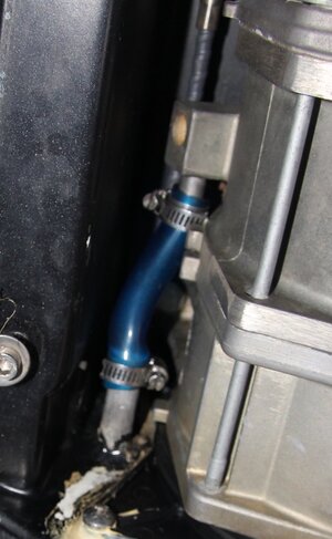

I notice the fuel check valve needs to be replace,

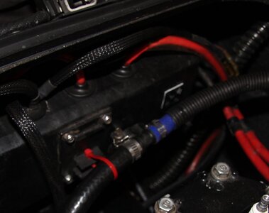

all the water hose are in good shape, dual cooling
But my hull cooling tube are half a inch instead of 3/8 and when I put my mechanic in the Trinity hull, the over heating problem started
