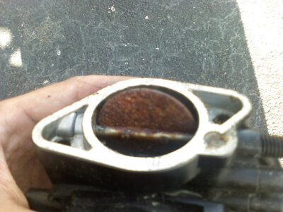

i checked the compression....160 front 165 back (on completely stock 650)...so i figured that was pretty good. I popped off the carb and found the choke had totally been rusted...however the rest of the carb looked good.

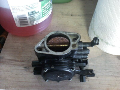

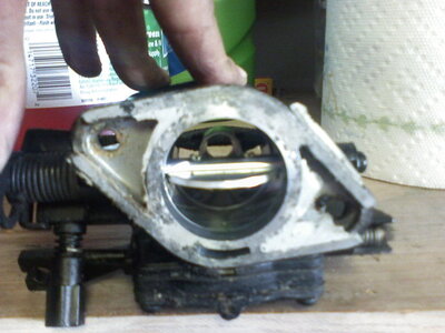

i started taking it apart and took some pictures. keep in mind i'm new to the mechanics of a carb...so if i had to rebuild it I probably could...however I don't know what a carb that needs to be rebuilt looks like.

2. should i just buy a new carb for this thing with all the rust on the choke? there doesnt seem to be any other damage to the carb besides the rust

You should rip the choke out of there anyway and get a primer kit for that bad boy. I dont think thats what is effecting it though. you usually dont have to actually purchase a rebuild kit. You can usualy get away with just taking everything apart and cleaning it with some carb cleaner.

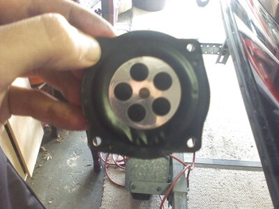

Are any of the diaphrams ripped or torn?

i haven't gone in all the way into the carb yet...i just took off the first cover to get to that black diaphram. there was some kind of wrinkling on the bottom of the black one...does that affect anything?

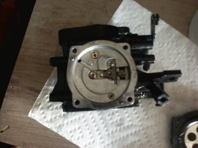

have you replaced your spark plugs, and remove your plug cap (twist off) cut the plug wire back 1/2 inch, spray sum lube on the wire and thread the cap back on.. your carbs looks good from the pics, remove the jet plate and check under there.

The diaphram still looks pretty good. I would imagine the carb is fine based on the fact that you didn't indicate any kind of hesitations/bogs during acceleration.

woody, on the other side of the carb(no shown) there is alittle black looking thing that is a filter and sometimes gets clogged, check it while your in there! hope you figure it out.
