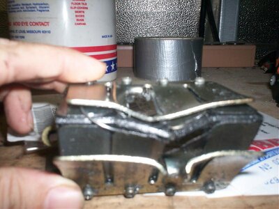

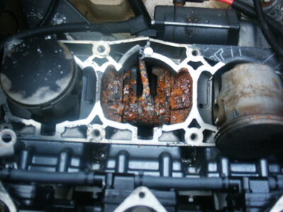

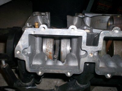

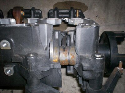

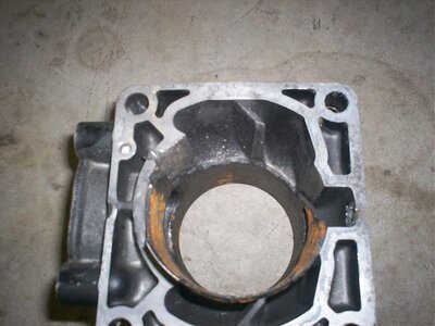

1100's and 1200's are pretty bad about that they have a minimum of clearance between the cases and the crankshaft.
WFO Speedracer
Alabama
Heres an 1100,I had one of these take out the cylinder,cases,starter,ex manifold , intake manifold and a reed valve.

My friend's old Kawie 650 SX did that because the ski sat around then he got it running. It destroyed the cases, cylinder, bed plate, starter, reed cage, crank, ect..
Well I thought it was pretty cool until the next year my X2 did the same thing from having too much water in the gas. Thos water traps Kawasaki use are a joke. I remove them from now on. Well my ski kept running on one cylinder. I guess I got lucky because my starter, intake manifold, and reed cage didn't get busted up.
When an engine blows liek that, it really blows a hole in your wallet! $$$$
