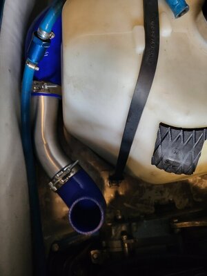

Yamaha still Sella the stock hose bit it's quite expensive. I just made a hose for my ski. I have a tnt center bleed chamber instead of the stock pipe, however the tnt chamber is designed to use the stock exhaust hose. I used a 2.5in id silicone 45 degree elbow, 2.5in od aluminum 45 degree elbow and a 2in id to 2.5in id 90 degree reducing elbow and made that work. For the stock exhaust use just a 2.5in 90 degree elbow instead of a reducing elbow. It was about 75-80 bucks total
