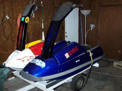

Alright, I think you're really just mixing automotive paint practices with generic "walk away" paints. When I painted my 750 with spray paint I did a few things that worked well and few things that didn't.
First off, I just sprayed right over the fiberglass and the color coat has held up great. I also used Minwax clear polyurethane clear coat. It comes in spray cans and costs about $5 a can at walmart.
What worked: I spray painted the pole black with 2 light coats of walmart brand paint and 1 medium coat and 10-15 minutes later, I sprayed the clear on it and didn't touch it for 24 hours. The pole has held up great under some nasty conditions.
What didn't work: I spray painted the hull in sections and used nicer spray paint for the better colors and then I sprayed the clear coat. The clear looks nice but it lifted really easily because I didn't get to spray clear until the color was dry and I didn't re-prep the color underneith because it looked so horrible when I tried. Also, if you're planning to paint your ski white, you can't use the minwax clear because it yellows. Barely noticeable on color but more noticeable on white.
Just spray it, clear it, and walk away! and whatever you do... Keep a steady hand and if you miss a spot, DON'T GO BACKWARDS! Catch the missed spot on the next pass or you'll get runs.
