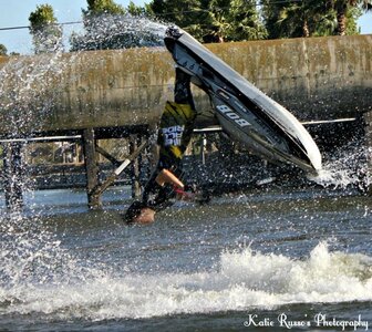

Back straight, throw your head back, bars to the chest. If you get the right motions, the backflip will be the easiest trick you can do.
