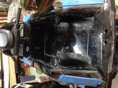

Hows it going i recently installed footholds on my 2013 superjet they came out really good only question/worry is that towards the back of the tray where underneath is the pump nozzle are one of the rivet holes went threw however a few friends looked and said it was fine dince its technically still on the outside of the hull so for those who dont get it i can take a picture just didnt know if anyone had anything similar happen if u look under the tray from the back of the ski theres some splintered fiberglass and a small hole but like i said its technically outside the hull anybody who has any info much appreciated i can take a picture i think it will be fine and i dosent actually matter but thanks for any info

I'd be nice to see a pic to see how far it splintered the fiberglass. It's probably not a big of a deal, you just don't want the crack to spread.
Question, how to you installing your footholds? You're going to glass them in as well? Make sure you lay some glass in between the footholds to add some strength back.

Yeah in going to be glassing over them now and i def will glass between them didnt think of that did u see the picture above i think they came out not too bad ill have to snap a pic of where the rivet hole went threw but i think it doesnt matter there since its solid there but well see
