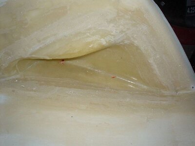

funny thing happened, i took the old foot holds out of the tray thinking the foam had to be saturated, it wasnt , its as dry as new ,i even dug a small hole out of the center and still dry.
now i dont know why because the foothold defently were cracked. there is however a air gap between the foam, ill post i pic in a little bit.
T-bone
brraap....thats so 2002
its hard to tell, but there is a 3/4'' air gap in the foam, its like they filled the bottom with foam then the top and then assembled the two halfs.
