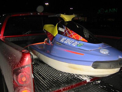

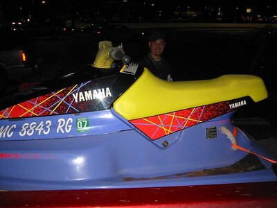

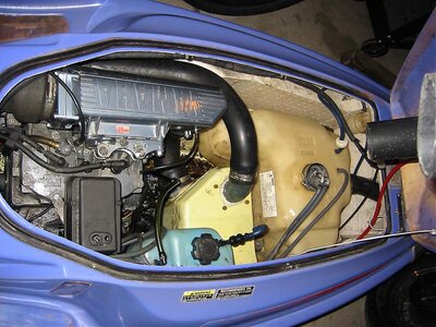

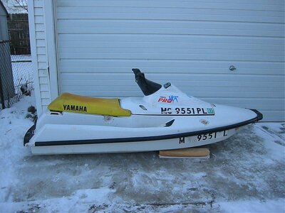

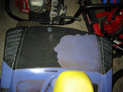

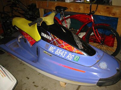

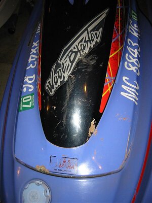

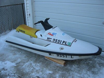

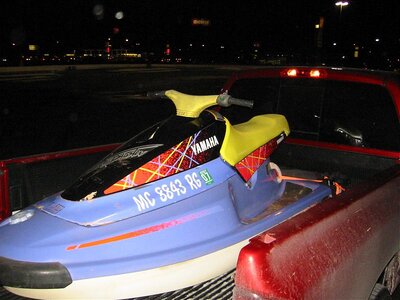

Great ending to a good story. I wanted everyone opinion and I thank you very much. I was sitting in the living room when the guy calls me and says they got to go he needs room he gave me both for $500.00. First The 1994 blaster I took a few pics in the back of the truck but it was gettign dark. The other parts ski is a 1993 Yamaha VXR Pro I am sure I will be parting out. There are a few parts missing but for the most part all there. Let me know what you think.

Nice find. I dont see any Hydroturf on that blaster though.:Banane37:
Edit: duh....you said it needs new turf....not it has new turf.

Awww man, it's a shame someone would let a Blaster get in that condition. Overall though, all it needs appears to be minor cosmetics. If I were you, I'd yank the motor out of the VXR (I think the Pro also has the 701 like the WB1) then get rid of the VXR hull. That way, you'd have spare parts for the WB1 if you happened to find some broken pieces as you did a tear down and restoration. Turf for the WB1 is a piece of cake, sand the paint off and rattle can it with black spray paint, buy a new set of UMI bars for it, yank the motor and do a full cleanup of the inside of the engine compartment, toss it all back together and put new plugs and a f/a on it, and viola! You'll have a sweet ski! Ride it for the summer and then toss a pipe on it over the winter, and you'll be having a good time with it in Daytona 09!!
