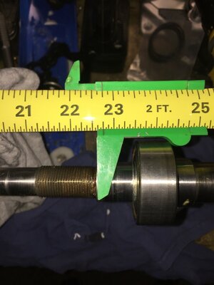

(Found) 26” Setback driveshaft
most guys measure from end of splines to edge prop bottoms out against. that is how shafts are measured and compared. Do a search and you will see all of the ones close to what you need
1996-2007 OEM SJ. 21 3/8
1996-2007 Skat Track Mag setback shaft. 22.75
Standard Skat track ”setback” Mag pumps set the prop back about 30mm. Not the 1” everyone says
