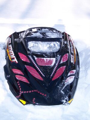

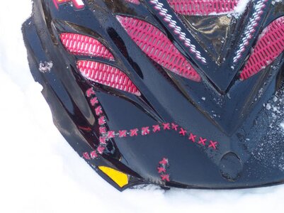

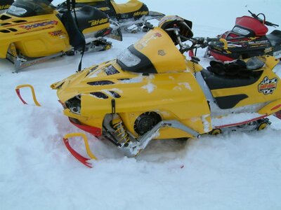

I just found some pics of a snowmobile hood I repaired a couple years ago for my buddy. I used #16 AWG TEW fine strand copper wire with a red jacket and laced it back up in staggered holes. I originally did it as a joke but it ended up being much stonger than anticipated and was still going strong 2 seasons later when he sold the sled.
I drilled out the end of each crack and layed out the holes with a marker. Each crack is done with one single "lace" pulled as tight as could be managed and then crossed over on the underside to the next set of holes to add strength, just as you would lace a shoe.

$450-500 new plus paint. Used are around $250. Well worth the time to patch up and get a few more years out of at that price. Especially when you think that you could roll your sled in the mountains your first trip out and wreck your new hood.
My buddy loved it! He called them his battle scars. He rode his ski for 2 months all cracked up and flopping around and was too cheap to replace the hood and too lazy to repair it so I did it myself when he left his sled in my shop for a couple weeks.

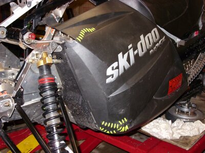

heres my sled i built....
not in it for looks im in it for fun and when it doesnt look good then you can have more fun
