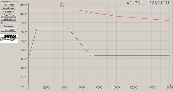

Well I have the new WAX ignition and I would liek to play around with some ignition curves.. I have a few I have tried but I was jsut wondering what everyone else is running.

Paul can you tell me what rpm your ski is getting at the moment up top
Also what jets are in your carbs
as if you are slightly rich you can bange a couple more degrees in it and get it to hit harder down low

Darren Hedlund mentioned either in a chat or a post on pwctoday that on Yamahas he always ended up around 15-16 degrees final timing.
waxhead said:
wow thats an interesting curve
i would like to see it at about 17-18 on a b-pipe at 7000 rpm

Here is the curve i run in my type 9 race boat
its work very well
i still want to play with more advance down low but other than that it pulls hard
the boat will pull 7600rpm
