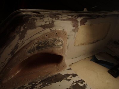

hey everyone, I;m starting my square build and fig Id start this to get input and ideas from everyone, This will be my first bare hull up build and Id like to do it right....thanks to paul at LPW,Eric fox and X-2 additct for all your advice,input and parts so far.Also all the other x members that have worked out great deals with me on parts. I will post pics tonight of my starting point,
Its a 1993 square hull, I plan on keeping it the stock white color as the paints in decent shape up top,

thats the basic plan, Im sure im forgetting some stuff, I just hope I can get everything done as im currently busy as HELL and ridings my only escape, Ill throw some pics up tonight of the hull and motor,
