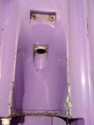

I then stripped the ski down to nothing. Cut the tray area out to access the pump shoe area from thie inside to lay some glass.

the new pump shoe went in fairly smooth, after a lot of grinding. Also have the engine compartment dyed black now. Should look really good after I polish the B-pipe chamber and ADA head. I also cut the rear edge off at the bond line.
