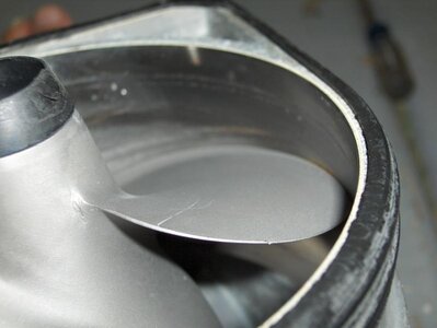

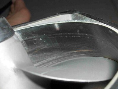

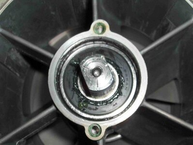

Well I pulled my pump apart tonight and did not find anything funny. The bearing under the cone looked pristine. I do not have a prop puller nor the bearing puller for the pump so I left it at that. My wear ring looks a little beat up but the prop has no dings. The clearance is within manufacturers specs. I think that the grooves are just from junk going through. I started it on the hose and noticed that the vibration still seems to come from the engine compartment/hood latch area. It only happens when I am at WOT. Idle it sounds normal. Like I said, my friend's SXR is that same. Well anyway here is some pics of the pump for S**ts and giggles :headbang:. I guess the search will still continue.

:fingersx:....j/k. I was actually surprised to see how good of shape the prop was. There is always all sorts of driftwood and crap floating in the lake that we ride at.
