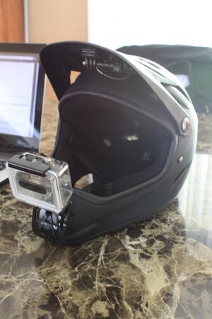

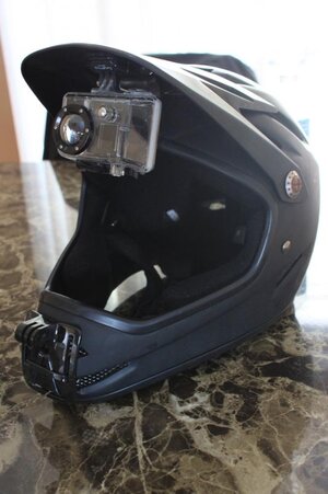

Alot of people mount theres up on top of there helmets, I am tried that and dont really like it, Im not 7 feet tall so looking at my video as if I was looks goofy. plus I like to here the beeps to know what I am doing with the cam or even see the front screen. Heres the two that I have used the most.

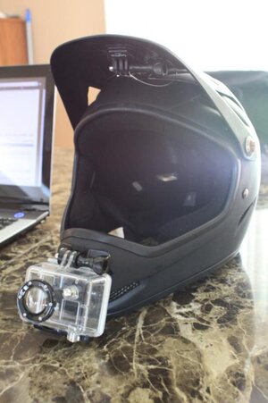

I really liked this spot because it gives you a really good view of everyone else. always looking right where you are and I could flip it up to see the front screen. Big issue though is that it pulls down the front of your helmet over you eyes so you are constantly pushing it back up.

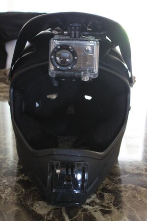

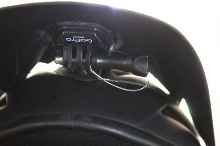

Here is my new setup, I have used it twice and love it. Perfect view angle, close enough to here the camera beeps, and doesnt pull my helmet down at all. I cant even hardly tell its there. it looks like it is kinda in your face but you dont even see it without looking way up. Also make sure you have some sort of lanyard to catch it if it falls off. you can see I have a stainless one running off it.
I left the other mount on since Im still trying this that way if the glue doesnt hold and it falls, I will just stick it on the other mount (mechanically attached) and keep riding.

I really like that mount on the front of your helmet. Is that the chest mount and you just cut off the chest part? Or is there a special one you buy for that? and what about when you edit the video won't it be upside down?
btmboards
Brett
Oceanside, Ca
it is the head band mount that comes with the gopro and I just took the straps off.
that is the way I didnt like it because it pulls the front of your helmet down once the padding getts wet.
No there is a setting on all the gopros to film right side up or upside down. Mine is set to always film upside down

Profound dynamics is definitly some good tuff stuff. If you got the money, his lanyard and a floaty is a good way to go. On the other hand if you are a broke a$$ like me may stainless lanyard the loops in and through the helmet air vents cost me $1.75 and about 15min and it is tested to about 75lbs (a whole lot more then a gopros drop weight from 4 inches)

See that is one of the things that I like about both the places I mounted mine. the back of the cam sits against the helmet so it is always at the perfect angle. I make sure as I mounting it I just temporally mount it,put the helmet on, and walk around my house to see how the video looks, make changes, try again. though with it on the top of the helmet I think you will probably have to just find the right angle and sinch it down real good.
