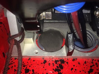

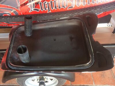

I got my first ski a couple weeks ago and was wondering if my pole vents are ok the way i got it.
6.jpg 9.jpg The reason I ask is because all the ones I see run all the way up into the pole with no wires showing. My hood is vented so I'm guessing the engine is getting enough air.
It is a Group K milled head, yamaha 701 bored to 710cc with mild porting, carbon reeds, and factory b pipe.
It is pretty hot where i live so I don't know if it's normal since it's my first ski. but i rode with shorts and the water that comes out the side burns when the wind blows it on my leg. But the ski ran fine to me. Just wondering if it is maybe getting too hot and what i have to do to fix it.. I am planning on getting either an xmetal pole or rrp since the umi pole on it is pretty long and it doesn't really help me since i'm 5'7. I was thinking about having it chopped but still don't know if it's worth it

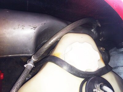

The breather tube appears to be broken off flush with the the pole bracket. This could cause undue wear on the cables/ wires and certainly a lot of undue water intrusion into the engine bay.

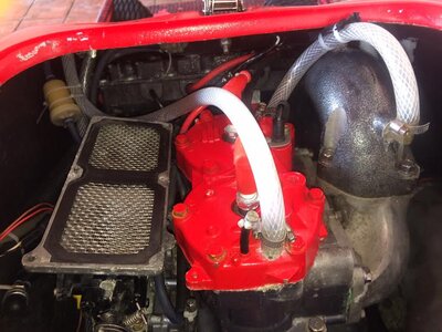

Do you have single cooling with the pisser outlets on right side of ski near tray area?
With dual cooling you'll have two hoses from bulk head supplying the engine with water, normally both go to barbed fittings on the exhaust manifold above the starter, with single cooling you'll have just one.
My old kawa 650sx has single cooling and a pipe and it's water outlet temp is hot, sorta burning, doesn't really burn but gives that impression when you feel it for sure.
On your poll it looks like maybe the right breather tube is split in two, can't tell on the left one though, looks like it's capped but then in that other pic looks like two coming down from above the water box.
Thanks, The left one has a foam stuck into it so it's capped. Is there a temporary solution for now that i can do to fix it?

I'm not sure if it is single cooling but there are 2 pissers on the right near the tray area. Yeah it doesn't literally burn but definitely feels like it ha

Those poll tubes are different colors, blue in poll and grey in hull... With that poll and pivot bolt set up it doesn't look like there is enough room for two tubes??....

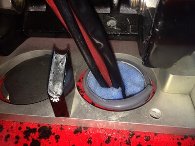

Also looks like you plugged the right one too with foam, good idea, water won't come in either and you get air thru hood vents. I'd prolly leave it alone until you get your new poll? Or see if two new ones would even fit and replace... Your next ones run them longer so they lay flat on the engine bay floor....
Is that ski from your area already? Looks like water temp about 75ish
Iam interested to know if dual cooling or not and how your ski water lines are routed, you can look at the bulk head behind the engine and look for your cooling lines coming in to engine....
Normally dual cooling 2 hoses @ bulkhead to ex manifold, rear head nipple to lower head pipe, front head nipple to pisser, front upper head pipe to a T overboard and to stinger

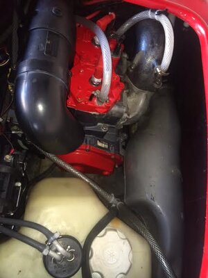

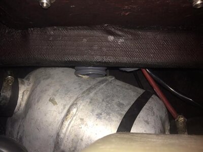

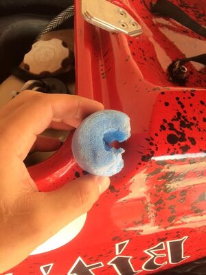

Thanks. The right one wasn't plugged when i got it. I just found a blue foam in front part of the hull. 1.jpg
So i'm guessing this was used to plug the right hole since it fits perfect.2.jpg
The ski was in California. I live in Aruba and the water here is warmer. The foam makes me think if it was the vacuum in the bay that pulled it in.

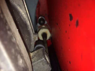

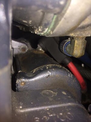

I tried to locate the cooling lines but to be honest I can't see behind the engine.

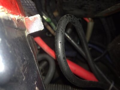

This is what i could see.
I tried to shove my phone in the back and take a picture but didn't really work out

And you are right, I don't see how two lines will fit there with the bolts. I'm pretty sure it's like that from when it had an rrp pole on it

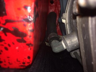

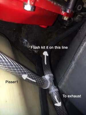

image.jpg This line going to exhaust does it go to the lower head pipe nipple??
You can look at your pump from rear of your ski and check for dual cooling too. Viewed from rear of ski you have the steering nozzle first, then reduction nozzle, then next further in is the stator section. Look on either side of the stator section, does it have two hoses one each side going forward to bulk head or just one??
The reduction nozzle may have a capped off nipple coming in at a 45 degree angle on the left side, these are used for bilge siphon when scuppers and pumps are not used.
I did more searching of b-pipe cooling set ups and I found a bunch I've not seen before, more than a couple looked similar to yours so far.
You might be able to view your manifold nipples with a mirror and flash light, everything probably fine I'am just Wondering now that you've asked

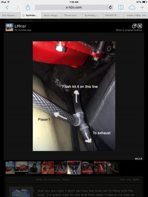

Luckily I took a picture of it earlier.
photo (12).JPG I had to brighten the image a lot so you can see it. But that is the picture with the arrows from another angle and you can see where it connects to the pipe.

Thanks that helps, when you get time have look at the lower part of the head pipe on the " back side down low" should be a cooling hose on it as well, I'd like to know where it's plumed to..... The head pipe connects the silver exhaust manifold to your gray chamber for clarity.

Ok so I found the line you are talking about under the head pipe but i couldn't follow it, my hands won't fit down there and i didn't want to remove the chamber atm. I think i will have to get a small mirror that i can manage to get down there in the hull to have a look.

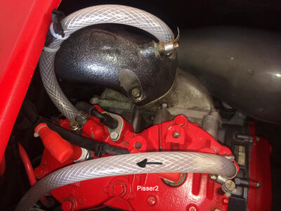

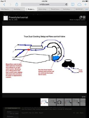

Cool, good shots too. Didn't want you to take it apart, just Have a look. So you have single cooling which is fine. The good new is your pump and bulk head are already Plummed for dual cooling so prolly only manififold may need a second
Hole drilled And tapped to set it up. My old 650sx is set up pretty much the same and the waters pretty hot out the pisser but it's normal... You could upgrade to dual cooling pretty easy, here is how mine is set up

I saved that diagram for later. Its very helpful thanks. In the future when i have to work on the engine i might upgrade to dual cooling.
