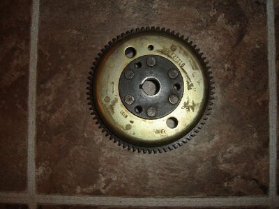

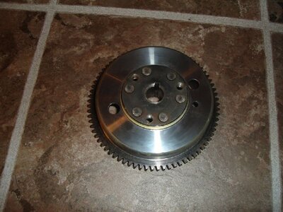

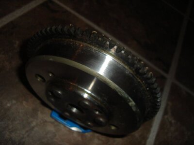

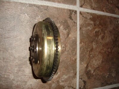

got my flywheel back from group k
I tried contacting jr magoos several times in a two week period. I left messages and by the time I got a response, I had already sent it to group k. I took before and after pictures. I figured they would take off more, but at least it will be reliable. Total was $79.00 + shipping

Did you happen to weigh it before and after? If not, what is the weight of it now? I chucked mine up in a lathe and did the same thing last year. I can't believe they charge 79 bucks for something that takes about 15 minutes.
I'm not sure about the weight before or after, I don't have a scale that accurate. They were supposed to take off .5lbs. The front face and side were both machined.
I've read too many horror stories about aluminum flywheels breaking apart and taking out the stator electronics. I'd rather have the reliability over a little quicker throttle response. My ski is a ticking timebomb the way it is
