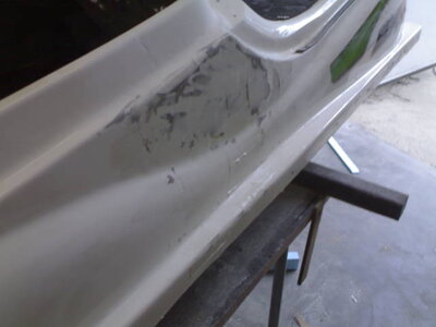

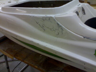

I

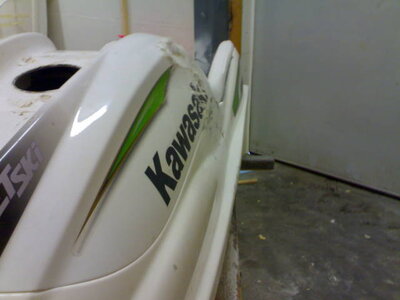

Now it need only one layer of topcoat and some wetsanding to make it look new again.

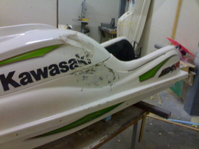

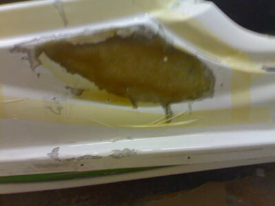

that stock hull is so heavy... im trying to grind of all the extra glue off to save some weight. But i think in racing ski it isnt not that bad when you have heavy hull.

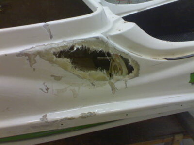

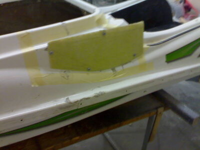

I
that aint first sxr that i have seen cracked in that place... It is the weakest spot in hull. That hull hit rock when doing some stupid show off. Friend of mine cracked hull in same spot at racing at finals.

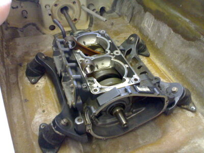

I
Got some parts last week, also i started to put that motor in the hull and got the coupler ready. And it seems i need just drill new holes for yamaha stock motormounts, height is almost perfect. I justforget to take picture about that.
Thanks for Thrust innovation and Trinity composites about some cool parts!

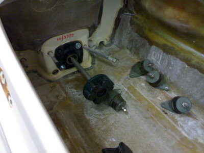

I
Here is yamaha coupler make t fit kawasaki driveshaft
