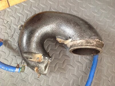

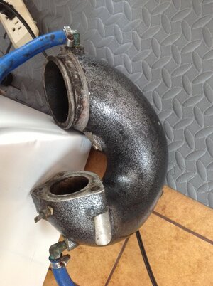

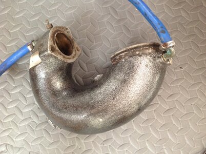

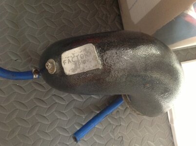

Can someone please help me identify if this is a yamaha 701, or Kawasaki 750 head pipe
Thanks in advance,

From what I know headpipes are same for Yamaha and Kawi, just different manifolds and expansion chambers. But this one looks like older style Kawi two screw pipe

I noticed that the two pipes had slightly different angles. I would like to know if that Yami B Pipe is going to fit the Kawi 750?
the flange where it bolts to the manifold are different thickness on the two. the kawi is thicker and takes longer bolts. it will work on the yamaha manifold but since it is thicker, it doesnt fit in the center of the notched out area on the exhaust manifold and makes for less coupler clearance. most yami head pipes are stamped B-pipe but the old 650 factory pipes werent stamped with a B and may have been the same as the kawi headpipe. the yami head pipe will definatly fit your kawi 750

+1 kawa is thicker than yam , and the angle are little different
It will bolt up but not so sure if it will fit. The rotation of the bolts are different. I tried to use a kawi b pipe on a Yamaha motor (in a 750sx). And the head pipe was angled with the coupler on the side of the hull.
there are 2 different kawi 750 factory pipe exh manifolds. one for the limited pipe and one for the mod pipe. they no longer produce the mod pipes. i have the sxr wet pipe head pipe on a RN SJ right now and it does and did fit with no modification.

Did the headpipe you ran in SJ look like the one I have in the pics?
the only visual difference is the thickness where it bolts to the mani. the pic looks like the thin yami one but i cant be sure. thickness on the yami 21mm , kawi 28mm. the color of the powder coating is also different. its darker on the kawi and more silver on the yami.
