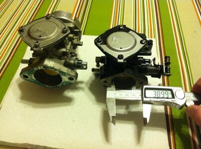

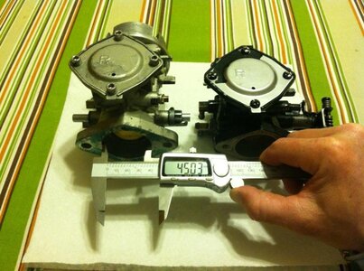

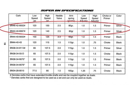

Bought a ski that had a set of "silver" colored Mikuni SBN carbs. Looked at the SBN manual and it appears that both the 44mm and 46mm versions came in silver (see attached image). I don't see any discernible model or part numbers on them.
Has anyone ever taken a set of calipers and measured the opening of either size carbs?
I'll upload a pic of them when I get home. ---> OK So here are the updated pics and stagesrt4 was correct. It appears that the base opening of each carb is approximately 1mm larger than it's stated size (see pics below)

Post a photo of the bottom of the carb. The machined step at the mounting flange is a different depth between the 46 and 44.

Reviving this as I need to identify a set of carbs 44mm or 46mm.
The actual bore where the butterfly sits is 1.813" or 46.05mm. So I'm assuming these are 46's?
