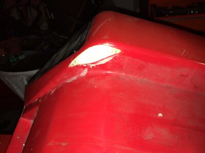

Ok so it looks like the bracket is not perfectly centered in the channel where it goes. If you look at these two pics you'll see how the bracket is closer to the LH side. IMG_0232.JPG

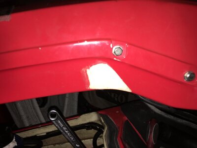

And here is the RH side where it has a little larger gap between the bracket and the nose of the skiIMG_0233.JPG

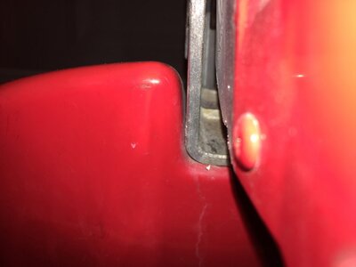

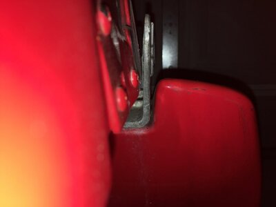

I believe this is making it rub on the pole and the groove on top of hood in these two picsIMG_0234.JPG

The pole bushing are probably sloppy and that will cause rub
The hood may not be centered on the hull
That bracket is siliconed on there is why it won't move
Thanks, I was able to release the bracket last night with a putty knife. Gonna center it up and reinstall then gotta replace a broken stop switch and put in new/used throttle cable. Mine would drag real bad, I found a break in the housing while it was still installed and once I pulled it last night there were two other bad kinks as well!!

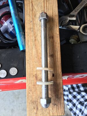

the bushing can wear also,not just the washers.replacement bushings are one piece so no separate washer.
you need to silicone the bracket in position also as the bolts alone will not hold it in position.
