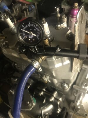

Does the leak need to be near the carb in order for it to pull fuel? I would think so. I wish I had tried that. I had to stop making noise and tear into it. Im not sure my neighbors like jet skis as much as I do, especially when they’re running away…been holding 8# for 8 min now…just like before. I wanted to test with the carb on by capping it off but was afraid of damaging diaphragms. And I think it would leak at the butterfly shaft. Do I need to test at 10-12 psi? I had to shoot a high rev for it to go
