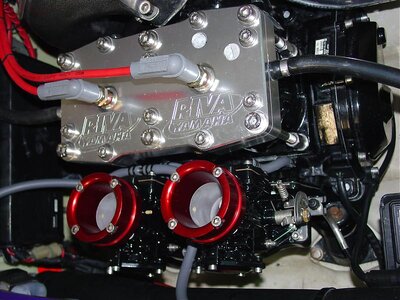

I tried buffing my nuts and they just rusted faster.
Take a look at my right front engine mount bolt. :scared: :aargh4:

Yamaha bolt are chrome plated steel, if they get crusty enough the chrome comes off when you wire wheel them . . . . . .
When ever my ski is gonna see salt water I hose it down with liquid wrench before and after I ride.
I use the stuff in the Blue can not the Yellow can. The stuff in the yellow can has some black Graphite crap in it, it's more of a penetrant for stuck bolts . . . .
